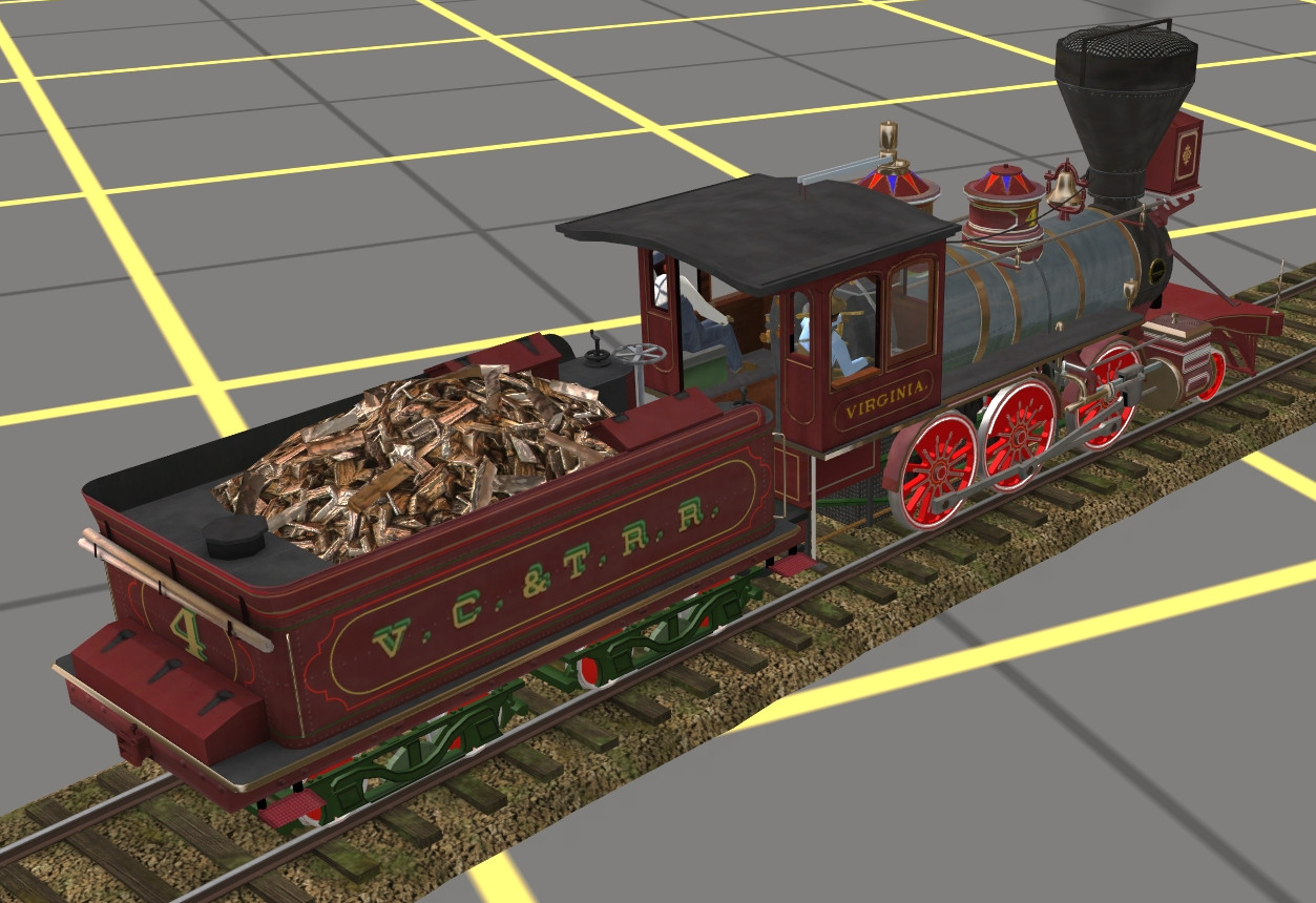

No problem! Yes, TS12 seems to have the same issue with the boilers. There's a beta version of a fixed mogul at http://www.carsoncarshops.com/beta.htm which should work a little better, although I noticed it's bell was still invisible on one of the latest TANE builds......
I've been slowly working through the content with errors and updating them, though I've been intermixing that work with new projects also.

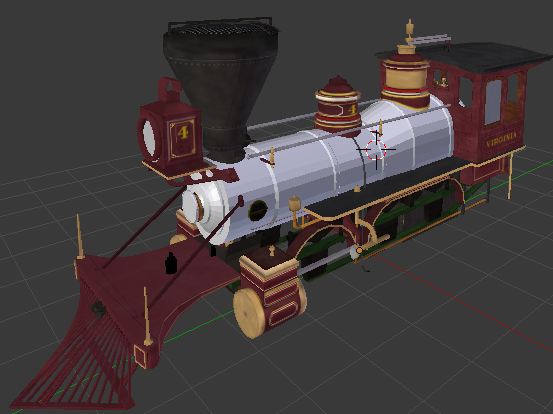

The bell needs to be re-exported from Blender also. For some reason, the newer versions of Trainz don't like the tbumpenv materials from GMAX (or at least the way I used them ;-) ). The major holdup is redoing the rope animation. It should only take 30 minutes or so, but I've been procrastinating.
Not the least of which is that I imported Mike Collin's mogul drawings into Blender, and it appears my model is about 5% too small. And the domes have the wrong profile. And the boiler profile is off; especially around the cab. And, and....
So, now I'm redoing it again....
I'm having the same problem with the combination boxcars. What started as a simple repaint / fix the .texture file error in TANE has turned into a complete rebuild of both the car and the trucks....

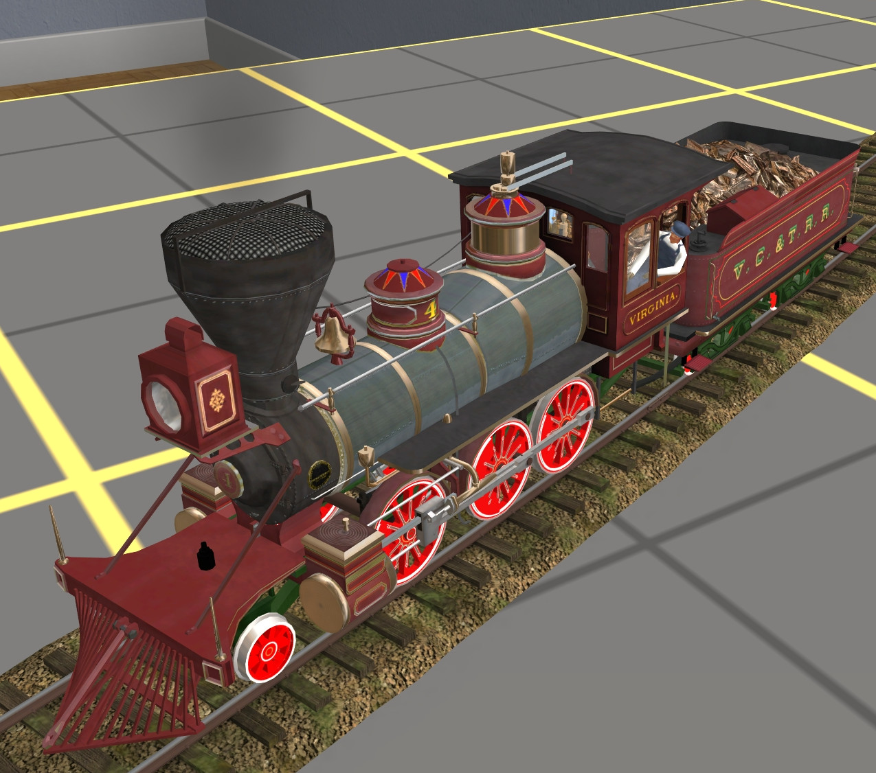

OK, new version on the beta page.
I (finally) got the vertex animation working for the bell rope, and tweaked the texture reflections. I'm also using the new bell code built into TANE, so the bell won't animate in previous versions. On the plus side, because I removed the bell code from my script, the mogul *should* work (albeit with a static bell) back to TS2009 SP1 by just changing the build number.
Not quite ready yet for release; I still need some work on the lods to get reduce the whole shebang to less than 500 polies at the lowest lod. Also have a little more texture updates.
I haven't touched the tender yet; that's next.

OK, I *think* this is it for the mogul (as long as I didn't miss anything....)
New version posted on the beta page; the tender is now fixed as well.

Don't know how I missed this update but better late than never...
Looks and sounds great! Bell animation is cool but, as you've noted, the bell does just stop in mid swing. Gotta tell that wiper to oil those bearings.
(oh, SHINY!)
BTW, I did notice the change on the dome tops. They remind me of one of the narrow gauge steamers from OZ. It had a similar pattern.
