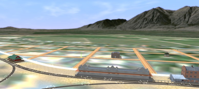

Here's a shot in TANE of some distant mountains using the fixed files:
- tane_mountians.jpg (75.91 KiB) Viewed 1125451 times

That is some excellent magic. Looks realistic enough I believe I recognize jobs peak! Looking forward to TANE
-John
