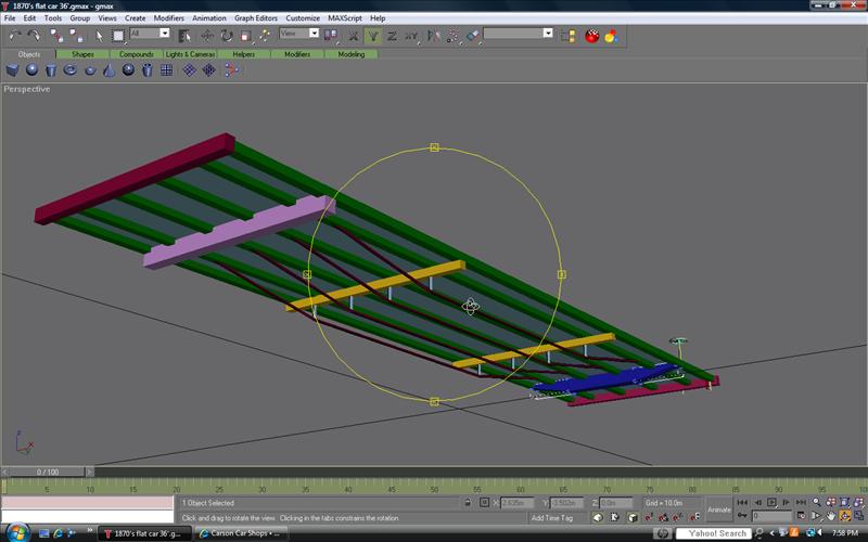

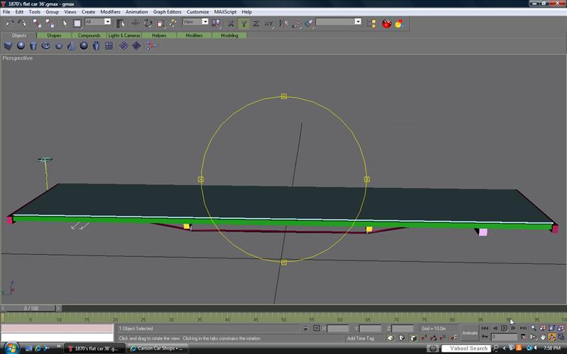

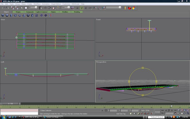

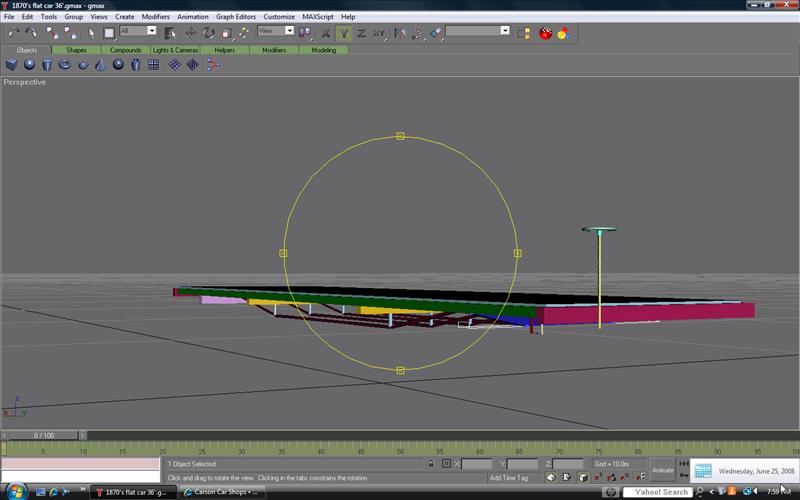

Re: First Project
Posted: Wed Jun 25, 2008 5:00 pm
by smokeygear
Re: First Project
Posted: Wed Jun 25, 2008 5:02 pm
by smokeygear
Re: First Project
Posted: Wed Jun 25, 2008 5:04 pm
by smokeygear
Re: First Project
Posted: Wed Jun 25, 2008 5:08 pm
by smokeygear
I made the images big so many of you can see any mistakes or faults I might have made. I am open to CREATIVE criticizimes. :D
Re: First Project
Posted: Wed Jun 25, 2008 10:15 pm
Looking good so far!
Your side sills look to be a bit small - the prototype sizes were around 9-12" tall and 4-5" thick.
This might be a bit of a nit-pick, but the truss rods don't actually bury themselves into the sills. They run alongside and then through the end sill, terminating in a large bolt. You can kind of see that in this model: http://members.fortunecity.com/gknowles ... _car_3.jpg
Hope that helps, and I look forward to seeing your progress!
