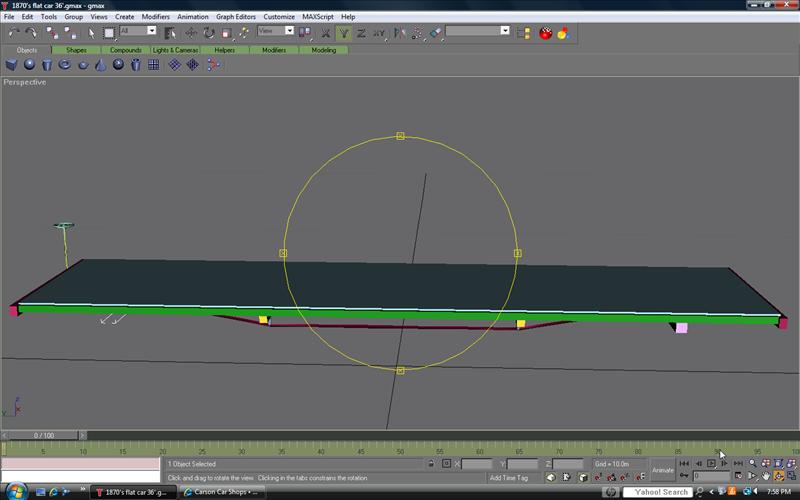

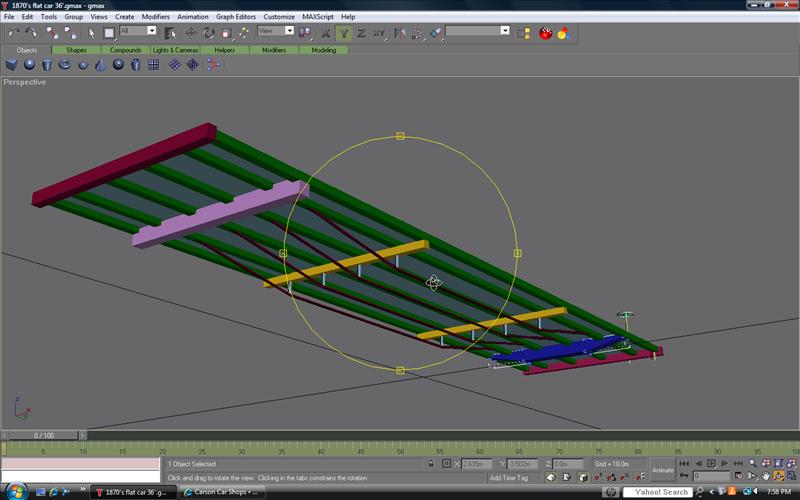

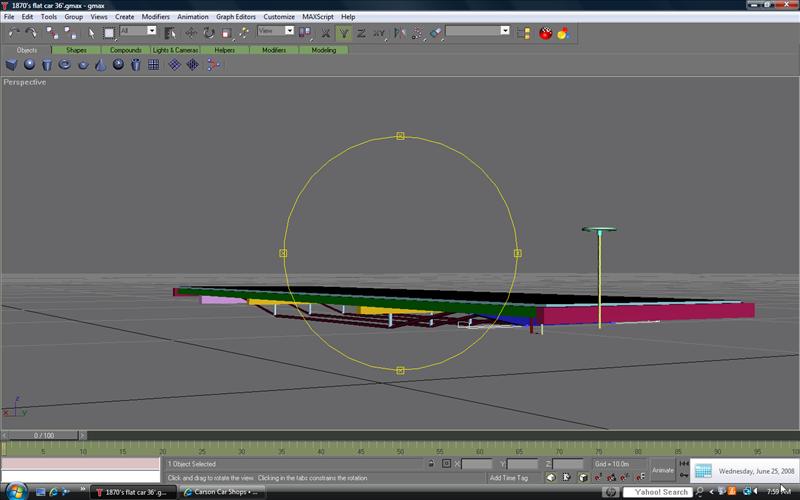

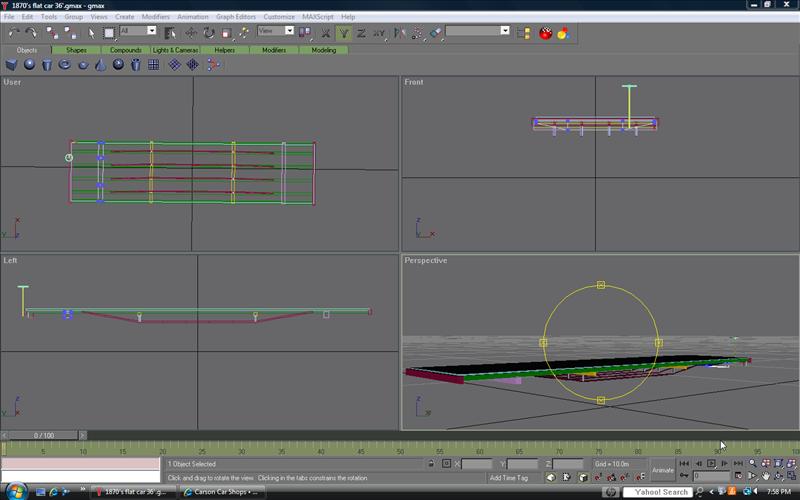

smokeygear
Posts: 83
Joined: Fri Jun 06, 2008 2:22 pm
Location: Stone Mountain, GA
Re: First Project
Post by smokeygear »
I made the images big so many of you can see any mistakes or faults I might have made. I am open to CREATIVE criticizimes. :D
Salutations
PO3 Darby
Re: First Project
Looking good so far!
Your side sills look to be a bit small - the prototype sizes were around 9-12" tall and 4-5" thick.
This might be a bit of a nit-pick, but the truss rods don't actually bury themselves into the sills. They run alongside and then through the end sill, terminating in a large bolt. You can kind of see that in this model: http://members.fortunecity.com/gknowles ... _car_3.jpg
Hope that helps, and I look forward to seeing your progress!
